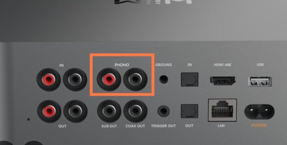

Have you tried replacing the cable connecting the TT and Ultra?
(Please try the cable included with the Ultra.)
Is it connected to the correct port?

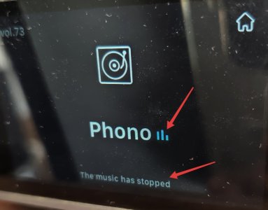

During record playback, what is the status displayed on the Ultra screen and the WiiM app's playback screen?
If Ultra is receiving a signal from TT, you should see the dancing icon on the screen moving.

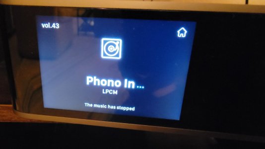

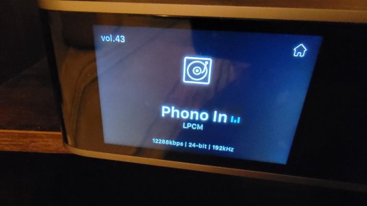

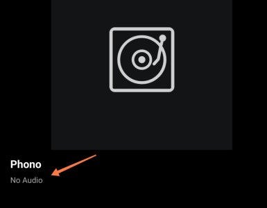

Just to clarify a couple of things that have come up in replies: I have swapped out the RCA cables with a separate, known-good pair and confirmed that the cables themselves are not the issue. I’ve also double-checked that the turntable is connected specifically to the phono input on the WiiM Ultra (not line in), with the ground wire properly attached to the phono ground screw.
One additional observation that may be relevant: when the turntable is started, the phono input does not show the animated signal/activity indicator you’d normally expect to see when an analog signal is detected. However, if I manually press the “Play” button while Phono is selected, the UI does begin showing the activity animation — but there is still complete silence from both the RCA line out and the headphone output.
So to summarize this point: the phono input does not appear to auto-detect or react to the turntable starting, and even when playback is manually initiated and the UI shows activity, there is still no audio output at all.This behavior is consistent across cable swaps, grounding checks, factory reset, USB disconnected, MM selected, and volume adjustments made while Phono is the active input.
