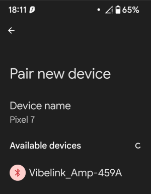

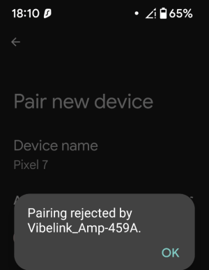

Strange one this ... I have the Ultra and Vibelink and have downloaded the latest WiiM App to control them on my Pixel phone. I actually have two exactly the same Pixel Phones and on one of them the Vibelink is recognised in the devices list along with the Ultra. However it is not on the other Pixel phone and when I try to pair it via Bluetooth with the Vibelink this is the message I get (see attachments) ... the Vibelink refuses the connection for some reason? I wondered if there was a limitation being applied by the WiiM to allow just one connected device but then I tried a different Samsung phone also with the App and it paired with that successfully. As far as I can see the two Pixels are set up the same as is the WiiM App so I'm scratching my head a little.

I can concur with this as I have it connected to one of the Pixel phones and also a Samsung phone. But what I don't understand is why it wouldn't pair to my other Pixel? I hadn't connected the Samsung phone to it at the time so there was only one paired device when I was trying to pair the second Pixel ... that's why I describe it as strange. And it's not the Pixel that's blocking the pairing it's the Vibelink ...

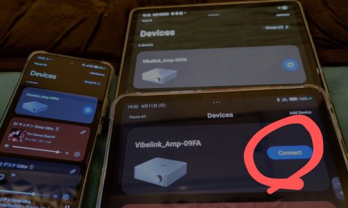

It seems that up to two Vibelinks can be displayed at the same time; I think the third one needs to be paired, but it is not necessary if it is not displayed at the same time.
Perhaps notification permissions also need to be switched on.

At first it showed the prompt to connect the Vibelink, but wouldn't, until I turned off the Samsung phone i.e. the second device associated with Vibelink. Once I had it then promptly connected. Turning the Samsung phone back on the Vibelink still shows except with the "connect" button is now displayed on that device proving the maximum 2 Bluetooth connections only are permitted at one time.
