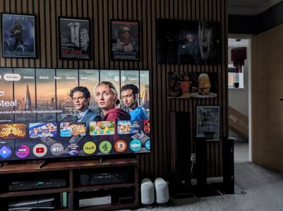

Placement wise...not much room for adjustment. So maybe a stereo measurement is the way forward. Here's my view from the sofa
1000026786-jpg.33403
Seems like a very cool space! :)
Like the other member with a similar cross-channel cancelation problem it seems there's a significant difference in distance to sidewalls from each speaker. I suspect this may be a factor.

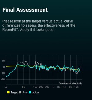

And here is the stereo result. Absolutely zero idea how to interpret so appreciate any comments!
This looks much better to me. Notice how the cyan curve is closer to the yellow curve between 70-100Hz (compared to the previous individual channel case), and how the notch around 180Hz is now significantly shallower than in post #1.
Are you happy with how this sounds?
Of course, feel free to adjust the sound to your liking with the tone controls. Bass/treble balance is largely a personal preference thing - this is why tone controls exist, after all. :)
