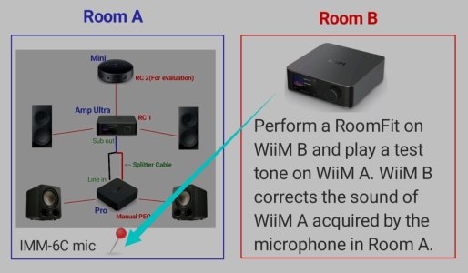

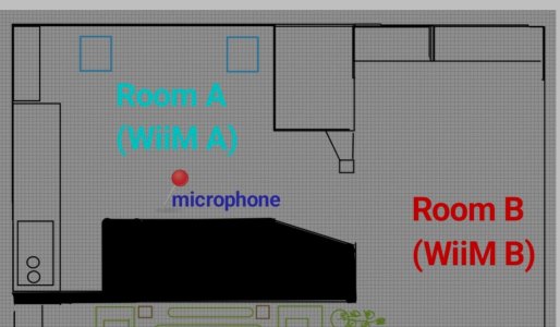

Perform a RoomFit on each of the two WiiM devices in two different rooms and compare the results of Room A measurements with the microphone in Room A.
In other words, find out if the WiiM in room B can compensate for room A. In my estimation, this is possible. Because RoomFit is running on the WiiM server.
[Test method]
  1. First, run RoomFit in room A with WiiM A as usual. Room A has a tablet with IMM-6C connected.
  2. Next, using the same tablet, run RoomFit on WiiM B. At this point, use the WiiM app on another phone to play a test tone from WiiM A.
  3. Copy the RoomFit profile created on WiiM B to WiiM A.
  4. Profiles 1 and 2 are evaluated with the WiiM Mini and the two results are compared.

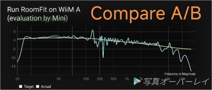

I started working with my favourite earbuds, enjoying the music. The end result looked like this.

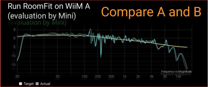

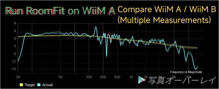

[Compare measurement results]
This photo shows the overlaid results of the WiiM A and WiiM B corrections.
1st time
2nd time
The response was slightly different for the 1st test, but for the 2nd it was almost identical. As I expected. The timing of the test tone playback was critical when measuring with the WiiM B. (I failed several times.)
Now I come to the main test 😄.
In the next test, I will use RoomFit in WiiM B to perform MMM in room A.

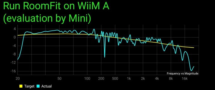

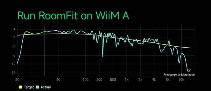

Before I do that, I forgot to mention that I need to check that the RoomFit evaluation of the WiiM A matches the evaluation by the WiiM Mini.

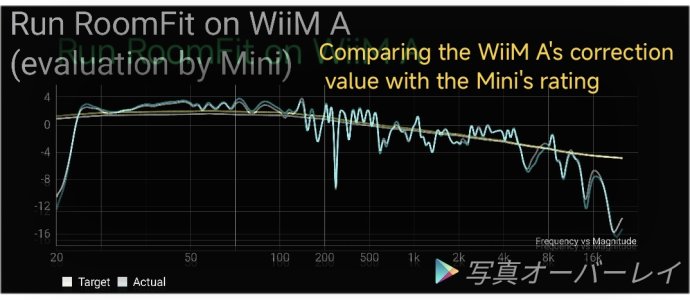

This is the result of the WiiM A correction.
This is an evaluation by Mini.
Overlap these two sheets.
Almost identical, no problems.

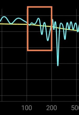

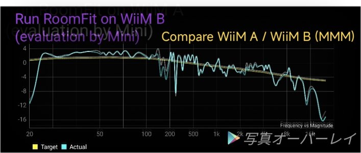

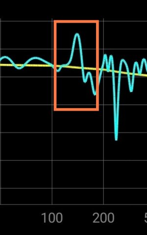

For the WiiM B MMM measurement, I played my pink noise track file. I increased the volume by 10% during playback to see what would happen. The end result looked like this.
The results are almost identical, but with a larger dip at 150Hz~200Hz for WiiM B.
Now, incidentally, I also tested Multiple Measurements (MM).
With MM, the test sweep is played back three times, but sometimes it is only played back twice (or once) and unstable. This time I will compare the results when the test sweep is successfully played three times: with WiiM B, I was able to the test sweep is played four times. I will see if this makes a difference.
No major differences..
To be honest, I was hoping that something good would come from applying this method, but unfortunately it doesn't seem to help at the moment 😢.
Today's experiment ended in a fiasco..
However, what I have learned once again is that the correction by RoomFit is uneven.
E.g., sometimes it shaved off the 150 Hz peak, sometimes it didn't.
I feel the results would be better if RoomFit could recognise the critical points and compensate for them preferentially. For now, I may need to take several measurements under the same conditions and choose the best one.
