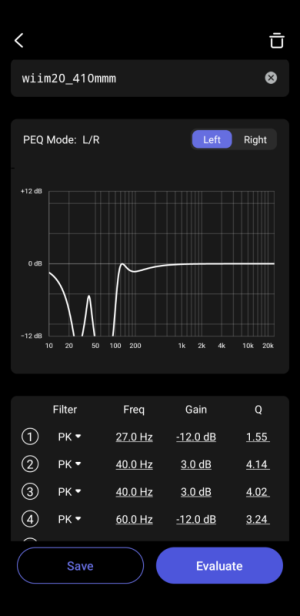

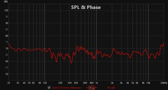

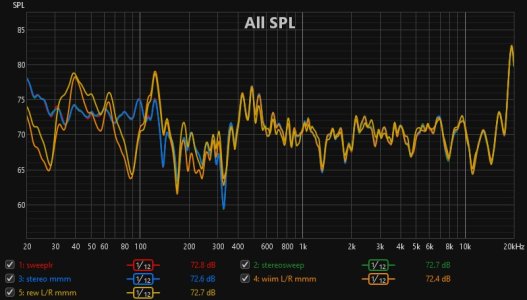

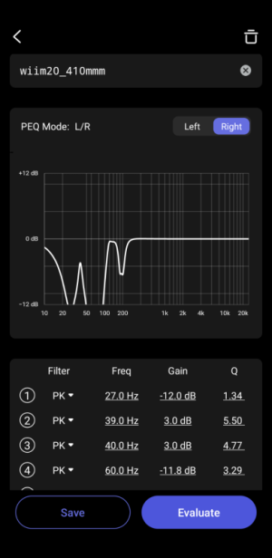

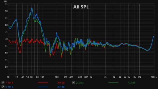

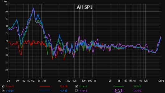

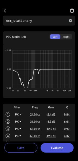

Exactly and the results I posted were using filters generated by REW so that removes all the variables associated with RoomFit as effectively I am only using PEQ and checking the results using REW and WiiM evaluation. I got the impression that the filters generated by REW gave similar results to those generated by RoomFit. Both gave a similar non flat response when checked with REW. So it seems to me Roomfit is calculating the correct filters but they aren't being applied correctly. I suppose performing the RoomFit should provide all the info about the raw waveforms etc which isn't available if I manually enter filters. It would be a lot easier to provide the info asked for if it was possible to export from the WiiM app.I guess they just want to reduce the number of variables to see if that helps pin-point the cause of the issue you are seeing.
Regarding this part of their response - I agree that some small variability is expected, but not the amount you saw in your measurements.
In my experience the match between predicted and actual responses is generally very good (in both RoomFit and REW).
