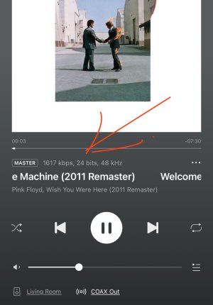

Setup: I was outputting the WiiM Pro into a DAC via a S/PDIF optical cable and playing Amazon Music with the ultra HD subscription through the WiiM Home app. I made sure to find a song that was the highest resolution (192 kHz). I could play hi-rez music at 96 kHz but it wouldn't go to 192 kHz. I used the "Play test audio" feature in the WiiM Home app's device "audio settings" section, and it would pay a test sound at 96 kHz but not 192 kHz.
Trying to troubleshoot, I bypassed the DAC and output the WiiM directly into my amplifier via RCA interconnects from the analog line out outputs, thinking maybe there is a problem with my Schiit Modi+ DAC. When I did that, I was able to play a 192 kHz signal and play the music over 192 kHz. So, I thought the problem was my DAC, but I know my DAC should be able to handle 192 kHz. Was there some weird compatibility issue? So I decided to insert the DAC again and swap the optical cable next. When I inserted the WiiM optical cable instead of my older optical cable, I could then hear 192 kHz! Just to make sure I wasn't crazy, I swapped back in the older optical cable and I was again stuck at a max 96 kHz. So it was the cable.
So, the moral of the story is, not all optical cables can support a 192 kHz sample rate. I never knew that before. Hope this might help someone else out there.
I don't really like optical cables because I find them fragile and they can come loose easily, so I've ordered a digital coaxial cable from Bluejeans Cable and I'm looking forward to using it instead...hoping it will work at the high sampling rate.
