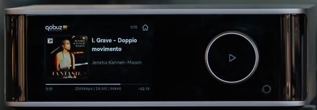

The Bit Rate, Sample Depth, and Sample Rate all show on a WiiM Ultra or Amp Ultra screen right at the bottom.
