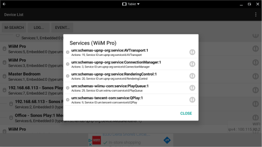

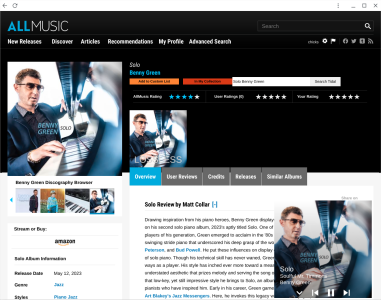

Use the WiiM's UPnP interface with Tidal's API. I do.
Hi,
Thanks for the reply, I tried something similar a while back using tidalAPI in python. You mention the upnp interface, is this running on a port on the device... I cant seem to find any details on it. Also a quick on one the client id.. i cant seem to sniff one out to use. How did you find one to use with the api? Im interested - the webpage you shared is that something you made with yourself with the interface and api?
John
Hi,
John
Have a look at my examples, both Python and Javascript (Chrome extensions) talking to WiiM, Tidal, Qobuz and Deezer. Please fork and improve.
A good UPnP tool, like this one for Android, will let you view all the WiiM's services and methods.
