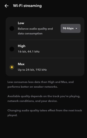

Is Tidal Connect able to be used with my Wiim Pro for their beta testing for their new flac lossless format?
Natively from my phone straight to my dac (Topping E50), I get multiple sample rate outputs for "master" songs but when I use Tidal Connect through my Wiim Pro to my dac, I only get 16bit/44.1khz or 24bit/48khz output.
This only started when I joined the bet testing on the Tidal app. Does Wiim plan on providing an update that will allow me to beta test via the Wiim Pro or will I have to do bypass the Wiim Pro streamer in order to beta test?

I also read only iOS but android gave me the option to join beta which also made an update available; which when connected natively to my mqa dac, behaved differently
this leads me to believe that hi-res flac is also a beta option for Android.
On my settings for Wiim Pro, I have to select beta mqa in order for my dac to fully resolve mqa...Tidal in the Wiim app, can't fully decode mqa, only Tidal Connect from Tidal app & this is why I think an update in Wiim could be the only fix for me to test via Wiim Pro streamer...

So the issue is with Tidal Connect not supporting the hi-res flac. Since wiim app also doesn’t support Tidal hi-res the only work around is to bypass wiim and connect straight to the dac?
Just tested it yes it works by bypassing the wiim pro and connecting a source to the DAC.
Oh well least I won’t waste anymore to trying to figure out why it wasn’t working.
