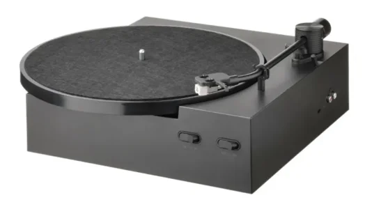

If your IKEA turntable is this one
Then it does have a preamp and you cannot switch it off so you are feeding line level audio into the phono input which is why it sounds “funky”
As per the previous posts you need to connect to the turntable to the line in RCAs on the Ultra
