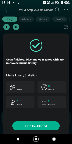

My Amp's Media Server had been working, at least until I decided to update my library. I edited the music files to update/change the genre tags. I also added a few songs and a few playlists.
Now when the app rescans the drive I get:
Songs = 0
Albums = 0
Artists = 0
Playlists = 7 The playlist names appear but underneath it reads 0 Songs
Genres = 0
Folders = This is where I see data. From here I can view albums (including art) and tracks. Music plays fine so it's definitely there but the App won't display it anywhere else.
I haven't yet submitted a ticket, but I intend to.
I submitted a ticket. Here is their response via email:
Thank you for reaching out to us, and we sincerely apologize for any inconvenience you've encountered.
To assist you further, we recommend downloading this special version of the WiiM Home app. Please use this version to reproduce the issue you're experiencing. After doing so, we kindly ask that you submit a new piece of feedback through the 'Settings' tab, then select 'Feedback' within this special version of the app.
Your patience and cooperation in this matter are greatly appreciated.
Best Regards,
WiiM Support
Special version of the app? That's new!
Followed the instructions And received this:
Thank you for your cooperation.
Your problem has been escalated to our engineers and efforts are being made to check and fix the problem.
We appreciate your patience and understanding while we address this. Rest assured, we are making every effort to rectify the situation and improve your experience with our product.
If you have any additional information to share, or if there's anything else we can assist you with during this time, please feel free to reach out.
Best regards,
WiiM support

This morning I received this from Customer Support
We have identified and addressed the potential cause of the issue. We recommend that you download and use this fixed version of the WiiM Home app. Once installed, please attempt to access your USB media server again to verify if everything is now displaying correctly.
I installed the"Fixed" version. Here is my reply via the Audio Help Center:
Thank you. The "fixed" version of the app appears to have worked. Although the total songs presented after the rescan (6000) doesn't agree with the number copied to the drive (12000+). This disparity is also present in albums and artists. Despite the disparity I can't yet find anything missing. Questions: 1. What was the cause? 2. Is there something I should be doing differently as my library continues to grow and change. 3. Will these "fixes" be incorporated into the widely available version in the event it needs to be reinstalled?
I'm hoping to learn from this experience in order to avoid future issues.
Again 🤞
