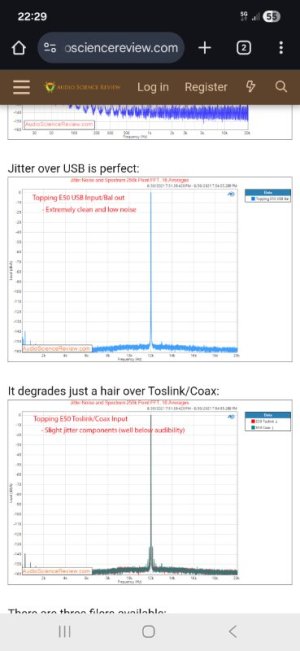

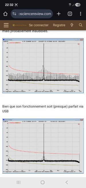

Ah, so it's me she's talking about... It seems to me there's nothing "eminent" about it.
PS: That's a non-issue...
Example: If the reasoning were correct on a modern DAC... how would you explain this?
Dozens of cases if you closely examine sites like ASR...
From what you've written, there shouldn't be, couldn't be, any difference... But there is...
(Why is another matter...)
Factual
Etc
Etc
Etc...
