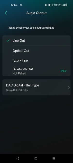

Where on the app can I find WiiM Pro Plus DAC filters?

I read enough about WiiM DAC and want to play with the filters. I’ve poured through the app settings and various threads, but I can’t find where I can choose filters. Any pointers would help. Or do I need to reset it?

Do you use your phone for the wiim home app or your computer? This is what does my wiim. Take a look: I did a an screen record. I selected super slow...and when I'm off of the list, it is sharp....filter selected. The solution is to select another one and then selecting super slow again. But if I close the app window from background on my phone, it changes to sharp again...

First you have to set the output to line out. There you will find the filters you are looking for.
I have the Pro Plus I click to where line out is selected playing music but i do not have a “dac digital filter type” box come up .. any further help would be useful
