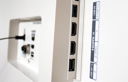

ARC/eARC should be able to deal with lip sync issues and it should be able to do so automatically, but according to this source it is optional with ARC (and mandatory with eARC):
As far as I know the WiiM Amp supports ARC but not eARC.
Good catch.
My TV is too old to have ARC so I use the optical input. My Virgin box does have an audio delay setting but it affects the TV sound over HDMI as well as the optical output so I can only have one of them in "perfect" sync. If the amp allowed delay on both main speakers and subwoofer I could sync both.
