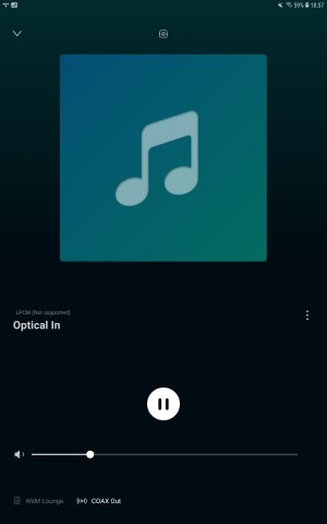

i tried Optical and OPTICAL both without success. I found another thread on HDMI and thats why I knew it had to be in capitals.
When i use that exact prompt the input changes to WIFI instead of intended optical.
Looks like a bug in the (undocumented) WiiM Amp firmware then.
Probably worth filing a ticket.
I would expect the version of the WiiM Home App to have a similar influence on the HTTP API as new batteries for the remote. :)
It should all be part of the Amp's firmware.
