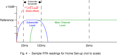

Please note that the .1 channel (I'm avoiding the term LFE or subwoofer here) is explicitly not part of the stereo downmix. Yep, that's actually true. A real LFE (there I said it) just contains additional, non-essential effects, not all the bass content below 120Hz. The main channels should contain all meaningful bass. More on this can be found here:
The Misunderstood 0.1 LFE Channel in 5.1 Digital Surround Sound - HomeTheaterHifi.com
In 5.1 digital surround sound, the 0.1 channel is called the LFE or Low Frequency Effects channel. While in the commercial system it is referred to as the subwoofer channel, this is not necessarily true for home theater setups.hometheaterhifi.com
