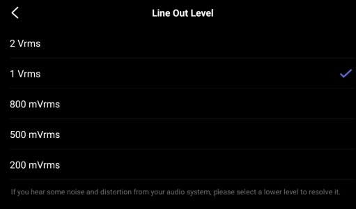

Picture below is what they are talking about for wiim output level.
Suggestion is you choose the bottom one, 200mVrms, as that most closely aligns with the 180mV input specs above.
Of course, you can choose higher if you want.
Wiim set to 200mvrms should allow you to use the amp's full volume range with small volume adjustments being possible. A higher wiim output would mean small amp volume movement resulting in larger volume changes, and reaching loud levels long before the amp volume was at max.
