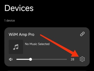

I have just set up a Mini into my Sony receiver; front/rear speakers working, however no sub. I am using optical out to receiver. Had no issues with B/T. My 'Device' tab shows 1 device, and I am missing how to get to 'device settings' Its gotta be something simple. I didnt see this specifically covered in other forums on the Mini....

Unlike the WiiM Ultra (but like the Pro and Pro Plus) the WiiM Mini does not feature a subwoofer output on its own, so there's nothing to configure. You can acces the device settings bytapping the small gear/cog icon on the device tile.
If you don't manage to hit it precisely the what's playing screen will come up. Just go back and try again.
