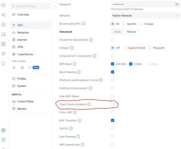

I was just looking for a solution for this exact same problem and came across this thread. As decribed by the previous poster, "professional" routers/access points have a feature that isolates WiFi clients (a WiiM device) from other WiFi clients (a phone) on the same network for security reasons. This was driving me crazy until I realized that the problem was my "prosumer" grade Ubiquiti Dream Machine router. See the attached screenshot from the router config. As soon as I toggled the "Client Device Isolation" checkbox, the problem was solved! Hope this helps others.
