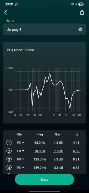

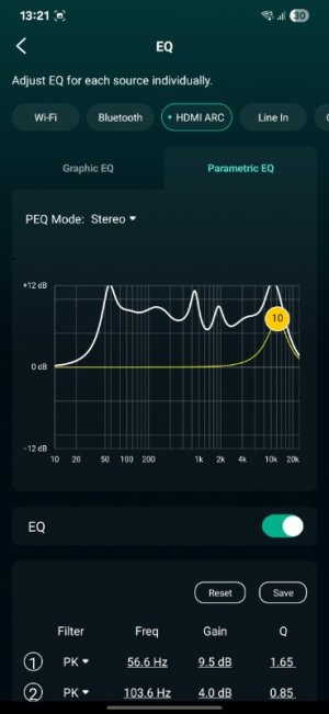

Hi I listen to youtube music from my tv on my wiim ultra when I turn on room fit and adjust the room sound just to make the sound sharper but the singer's voice or bass is not clear and sometimes inaudible or in other words the sentence is lost, the mid range is bright and clear. Can you tell me how to do this? When I turn off room fit the device is gone, there should be a low range that is automatically cut off, while my equalizer graph has it set to high from 50-200hz. Need an explanation!

From the screenshots it looks like you have too much boost. You can try the RoomFit settings values posted here.

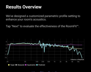

I tried following the setting on 20-300hz and here are the results.
