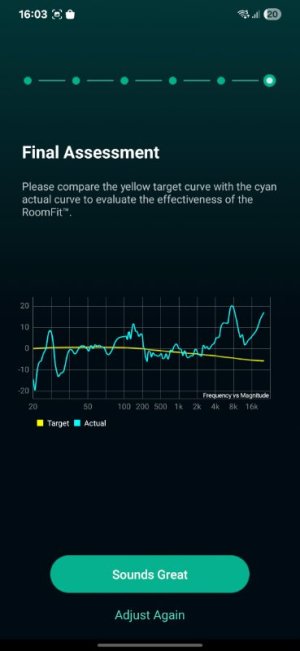

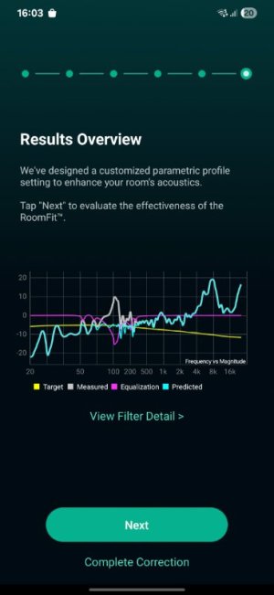

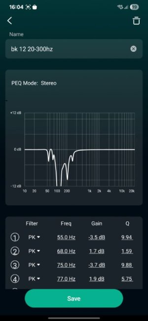

I tried following the setting on 20-300hz and here are the results.
