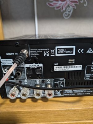

I just checked. Is your denon an amp/cd/radio?
If it is then there are no outputs on this, only inputs from what I can see.
You could connect the Ultra optical out to the dennon but the vibelink would not be used.

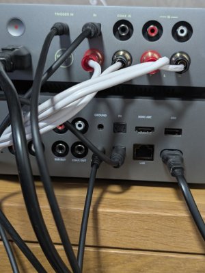

Big thanks for taking your time to reply to me, I have made two photos of what stands now and I'm able to use the Ultra and Vibelink together but what ever optic I use for Denon nothing seems to work and I note in Denon is states the Digital is "locked" which tells me when I look it up there is no connection or incompatible?

It looks like the Denon only has optical in, so that won’t do what you want.

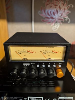

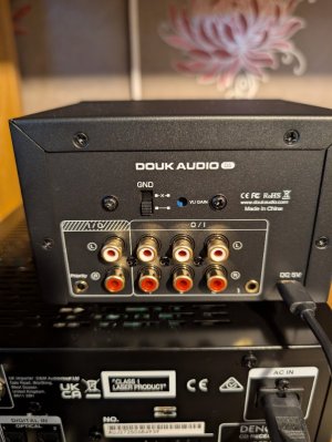

I may have a solution but I am totally stuck of which cable should go where for the speaker switch from Denon or WIIM any idea?
I don't think there's any other way than connecting the Denon headphone output to the Ultra's line input. You'll need a cable that converts the headphone jack to RCA2.

To connect the Douk audio d5 between the Ultra and Vibe, connect the Ultra's line out to the Douk's RCA input (left), and connect one of the four RCA jacks on the right side to the Vibe's LINE input. You will need to change the Douk's input/output switch to the 1 input, 4 output setting.
(However, personally, I don't see the benefit of connecting Douk.)

Are other speakers connected to the Denon?
If so, you need to connect the Douk's RCA output to the Denon's RCA input. Combined with the connection method mentioned earlier, you can output the Denon's CD playback through the Ultra to the Vibe speakers.
Denon (Headphone out)--> (RCA-in) Ultra (RCA-out)--> (RCA-in) Douk (RCA-out)-->(RCA-in)Vibe
Douk (RCA-out)-->(RCA-in) Denon
< Or Direct Connection Between Ultra and Vibe>
Denon (Headphone out)--> (RCA-in) Ultra (Optional/Coaxial out) --> Vibe
I think this is probably right, but sorry if I'm wrong.
