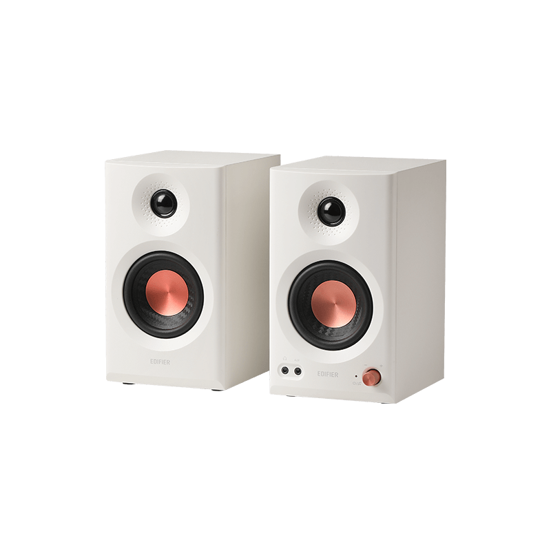

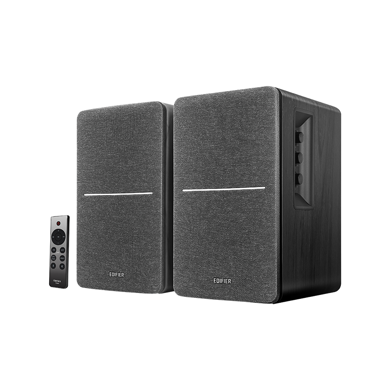

I’ve had the WiiM ultra for several months now and have a pair of Edifier R1280DB speakers connected via rca cable. The sound was OK but I settled on replacing them with some Hi Res certified Edifier MR3 studio speakers. I assumed they would have the same connections as R1280DB but I guess because they are studio speakers certain connections aren’t present. I really only clicked when purchasing them that they had RCA which was what I needed.
Anyway, I’ve asked Edifier the following question but they have yet to get back to me so I’d like to ask some advice/opinions from the forum.
1) The MR3 speakers offer several ways to connect to devices. The one way using rca suggests using the included cable, but it’s an rca to 3.5mm cable. Do you think it’s possible to use an rca to rca cable instead? What are your thoughts?
2) I wanted to check if rca connections can do 192KHz/24Bit Hi Res Audio?
3) The WiiM ultra has many settings to fine tune your speakers for your room. I wonder if you’d lean towards using the WiiM ultra to take care of this although I see the MR3’s has tweaks via an app and the obligatory dials and nobs on the rear.
4) I admit I’m a rookie when it comes to all the jargon and standards in the music world. I didn’t really configure the R1280DB’s much after plugging them in and purchased the MR3’s on impulse because of the certification. I admit these are budget speakers and I’m sure aren’t a match for some of the high end stuff. The MR3’s lack an optical and coax connection compared to the 1280’s, but reviews of the MR3’s seem to conclude that they sound good for the price. What do you guys think comparing the specs of the two?
5) Essentially I want to make sure I’m able to play music up to 192MHz/24bit, as I’ve got a new tidal subscription and it would be a shame if I’m not hearing the audio in all its glory, so if I can get some advice on my 1st question I can feel confident to hook up these new speakers. Answering the other questions would be a bonus. 😀
Yes, the unbalanced analogue RCA input expects the same signal, no matter if the other end is terminated with a set of RCA plugs or a single 3.5mm TRS plug.
Make sure to set the Ultra's output level to 800 mVrms with the MR3 for best usability of the volume control. The R1280DB should work best with the Ultra set to 500 mVrms.
The digital 192 kHz/24 bit Hi-Res is converted to analogue by the Ultra's DAC prior to being send to the analogue line output. Analogue signals don't have a sample frequency or bit depth by nature. But since the Ultra does support Hi-Res audio it will send the best possible quality signal through its line output to the speakers.
Looking at the back plate and the product page I'd say that the WiiM EQ and room correction is more flexible, so there is not much use in dealing with the speakers' controls. You can still try it, of course.
Honestly, on paper the MR3 don't look like a real upgrade compared to the R1280DB. They are different, but not fundamentally better. In particular the built-in amps are really low power. If you find that you like the sound better that shouldn't bother you. But the Ultra is really capable of much higher quality than any of these speakers.
Edit:
Actually amplifier power is very similar (2 x 19 W MR3, 2 x 21 W R1280DB, no mention of the distortion level and how the values are measured). Advertising is just different, stating 42 W for one and 2 x 19 W for the other.
