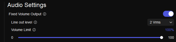

Disable the volume in the WiiM ultra. Use it strictly as a bridge to USB to the DAC. Then use the LS15's volume control.
I run my Ultras that way... no volume, no tone controls... just a plain bridge from WiFi (ethernet) to USB. I ran several DACs that way into different preamps... no issues at all. Running Tidal Connect.

So far as I know, by following the instructions, you can set the "volume to fixed". That means no gain/loss.
Furthermore, since the volume is digital.. if you bypass the entire DAC and go directly to the USB to run an external DAC, then the Ultra's volume shouldn't come into play. ( EDIT: I made an assumption... mea culpa).

since I got an Ultra right behind me, hooked up to a DAC(USB)->preamp->amp->speakers... I have the volume disabled (fixed). My DAC is also set up to unity gain, which means 2Vrms.
OK, playing some Black Sabbath... on account of Ozzie.
Using the remote:
(1) The MUTE button works
(2) The volume does not work, the screen shows 100.
OK, now, disabled the "Fixed Audio Settings"....
(1) Mute works
(2) Volume works... the screen shows the volume up and down (*)
Darn... so the volume works even when outputting over USB. I wonder what it does to the bit depth of the sound...
