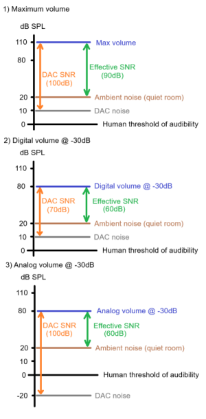

The WiiM volume control also work on the USB output. So just set the WiiM volume to your normal listening volume before running the RoomFit.
Welcome.
Because I'm untrusting, I set my external dacs to variable output such that 100% wiim volume is very loud, but not blow your speakers loud.
