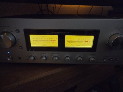

I had a 70's amplifer ( Yamaha) and altough you hear stereo , 1 vu meter is not working. You only hear it with 60's songs because the way records were taped that way .
I thought it was of because the old amplifer but now i have a " new " one ( Luxman) and it's the same . Its not the amplifer because its not when i play records and when i put the headphone in the Wiim Ultra the sound is also good .

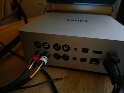

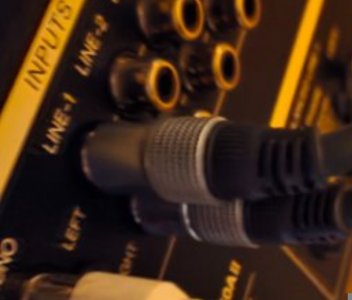

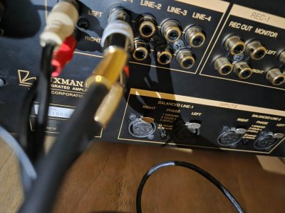

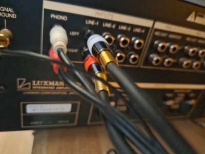

It's not entirely clear from this photo, but the red plug appears to be connected to the white (Left) terminal.1423.jpg
Please insert the red plug into the Right (red) terminal. Similarly, please insert the red plug into the Right (red) RCA output terminal on the Ultra.
Then insert the other plug into the white terminal.
Edit: Judging by the new photo you posted, it seems to be fine.

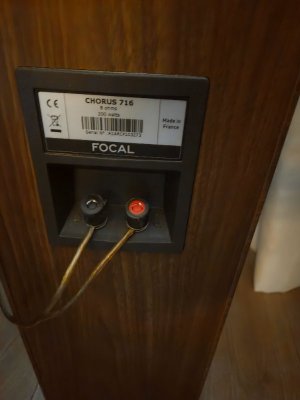

You have your speakers connected incorrectly by not matching plus to plus and minus to minus or left speaker and right speaker reversed. At the same time you have the plugs on your turntable switched around. This way it could work for phone but not for the WiiM which is now connected correctly.

This definitely sounds like you have plus and minus wrong on one of your speakers. Swap them around on the faulty channel and let us know what‘s happening please.
