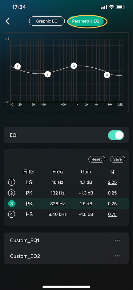

PEQ blog post now online.
This part below is disappointing though, now waiting to get more bands or at least 4 peak filters.
"Note: In this version of the PEQ, bands 1 and 4 utilize the LS and HS filters, respectively. Meanwhile, bands 2 and 3 employ the PK filter."
Submit a ticket to Wiim - hopefully if more people do, they’ll have to give into demand :)
Yes, we can do that, but it will require sacrificing some current features like Amazon MRM.
Hi, is there any further update on this? I know most commentators, myself included, have run with the idea that this isn't going to happen but rereading your post, 'Yes we can' is encouraging!! Should I extinguish all hope or might there be a chance :) Personally I wouldn't mind sacrificing other features but I appreciate this wouldn't be the case for the majority of currrent and future users.
