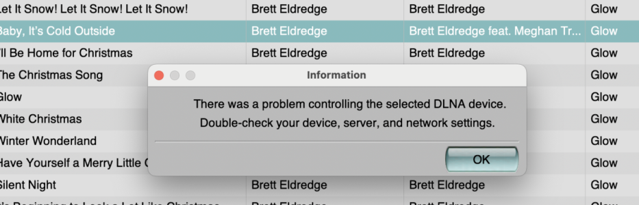

It was on "Original" ...and I get the following error. The WiiM never gets the file.....

Is that for just aiff or is it for all file types? It sounds like it is just aiff.
Do you have anything set in DSP Studio?
Can you connect from the Wiim to JRiver through Home Music Share and play that way?
I just looked at my setup and I have it set to Specified Output Format and PCM 24 Bit. I do not remember why but I do remember making that change. You might try that.
I also have settings in DSP Studio to downsample everything about 192 KHz to either 186 or 192 KHz, whichever is an integer multiple.
