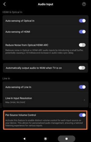

Please ensure that "Per-source Volume Control" is enabled in the audio input settings screen. If it is disabled, please enable it.
The WiiM amp has been modified so that the volume decreases upon reboot (I believe it was set to 30%). Enabling this toggle will prevent the volume from decreasing.

I have disabled this setting.
I will activate that and report back if the phenomenon continues to occur.

After activating volume control per source, I rebooted the device and the volume remained at the previously set level of 26. We will see if this also affects the problem I described.
