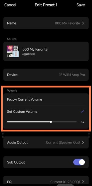

Btw, do you change the volume with the Smart Preset? If so, it is possible that similar problems may occur depending on the settings and how they are operated.

I don't know what smart preset is. I just change the volume within the app for the device. I always set it to 50% and never change it until this issue starts happening.

Smart Preset = Presets.
It is possible to specify the volume in the Presets edit screen and change the volume with the preset buttons.
Thanks. I'm not using any presets so no I'm not using this volume control here.

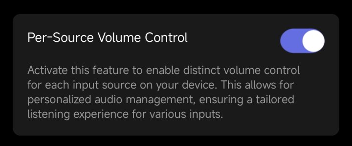

Does it change input when this happens? Each input on a WiiM device can have its own volume setting if per-source volume control is enabled under its audio input settings.
It didn't change the input. I'm using optical in since I'm using it for PC and it stays on optical the whole time.
