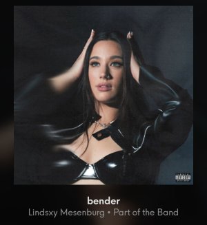

Strangely enough, AutoPlay works fine with Qobuz Connect from the Xiaomi 15 phone to the Xiaomi Pad mini. However, some albums still won't play even through the WiiM app. E.g., this one.
