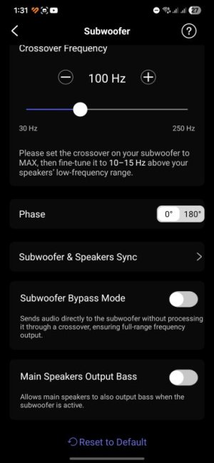

  4. Go to Device Settings > Sub Out > Subwoofer Calibration.

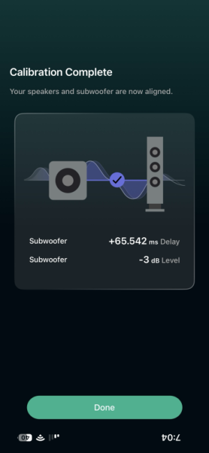

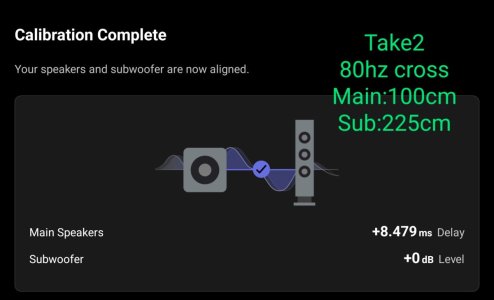

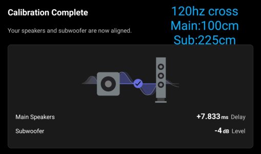

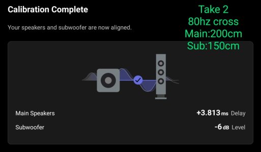

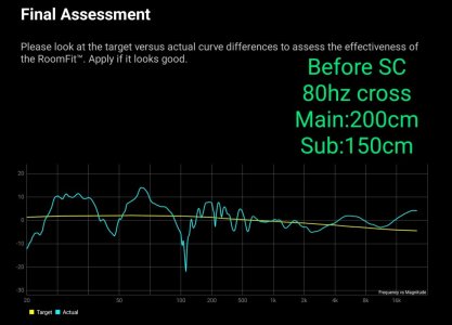

So-far-so good... My previous use of the [device] Settings > Sub Out > Sub-Speaker-Sync was pretty consistently putting an 11ms delay on my subwoofer. I ran the new "Subwoofer Calibration" twice in a row and got these somewhat different results:
I tend to agree with the first run regarding my sub's level setting - I've been running RoomFit and looking at the resulting filters and [geeking out and] tweaking gain, and my SVS sb1000pro adjusted gain feels about right. Nonetheless, I'll leave the 65ms subwoofer delay and -3 level adjustments from the 2nd run and see what happens with a fresh RoomFit run.

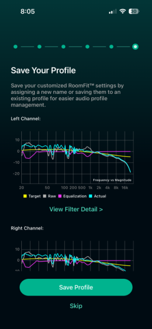

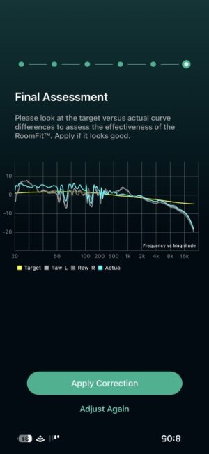

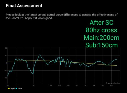

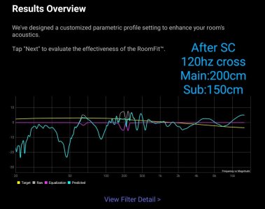

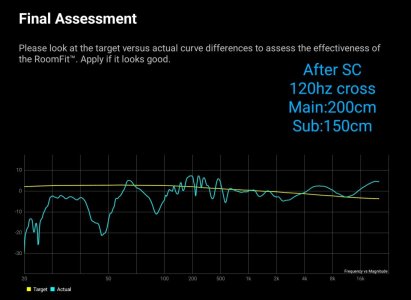

RoomFit: Looks pretty good. I'm not sure if RoomFit's "Subwoofer Calibration" switch-on function has changed in this BETA build? In any case, the following RoomFit Profile evaluation graphs show new RoomFit results looking OK to me:
1777519205693.jpeg 1777519225484.png.
Also, things are sounding fine - as they were previously :-).
View attachment 37352 View attachment 37353
View attachment 37356 View attachment 37357.
