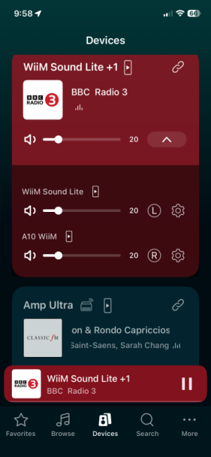

I can set a Lite A10 pair L and R. Not enough to form a stereo pair?
As Wiimer said not perfect, but with 2 identical speakers vanilla stereo might be possible.

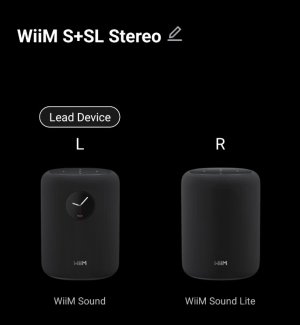

Back to the Stereo Pair feature. ;)
My boring name for the pair: WiiM S+SL Stereo.

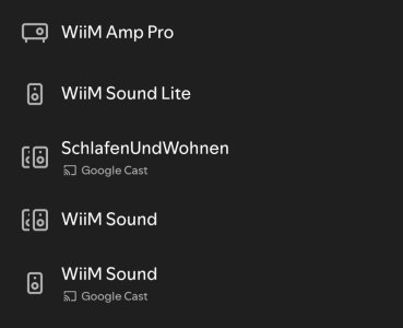

And this is what Spotify makes of it:
I can only tell by the icon that "WiiM Sound" referrs to a "group", which in reality is handled as one stereo device.
Switching between the different devices or - more precisely - selecting one of the individual WiiM Sounds breaks the stereo pair. I have to re-enable it in the WiiM Home App.

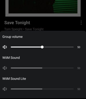

At this point I don't want to join the discussion if the final UI should rather be merged with the existing persistent group feature, but I don't like the way the group volume is handled right now.
Touching the slider brings up the group volume dialog, but at its core this feature is all about keeping the volume settings in sync. Consequently, there's no use for the group volume screen, it just takes one more tap to open it and another one to close it again.
