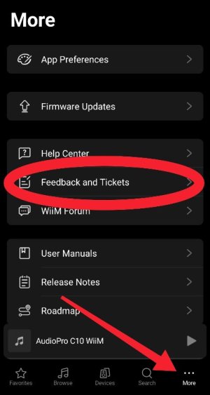

Have you raised a ticket?
There may be something Wiim can see in the logs that would explain why when your headphones re-pair with the Ultra the audio is “muted”.
What is the make and model of your headphones ?
No, not yet. First I'm trying to establish if I want something impossible, although this works flawlessly with Squeezelite and my phone. But according to @Wiimer this should be possible with the Ultra as well, so I might need to raise a ticket.
