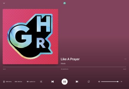

I noticed similar recently when they finally updated the iPad app to show artwork and metadata from Lyrion/LMS - the artist name was truncated. I didn’t think to try turning the iPad into portrait mode which does seem to sort it, even when I turn it back to landscape. I did submit a ticket but your additional info might be helpful when you submit your ticket.

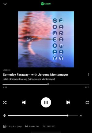

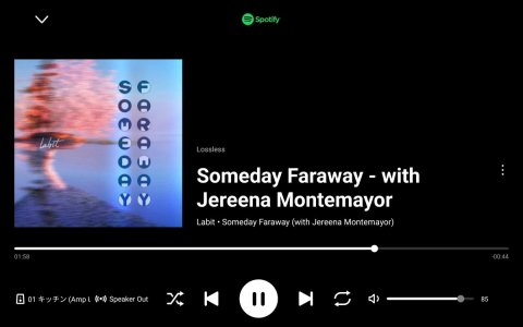

Is this due to different font sizes?
On my Android tablets, the title is two lines in landscape mode, but is not cut off in the middle.

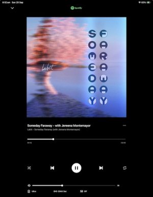

Here is what I see for the same track.
Notice that "Montemayor)" is missing on my landscape view, but after rotating it to portrait, and back to landscape, it is present in the next screenshot below.

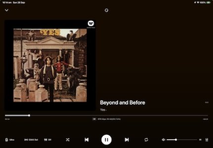

I should add that this isn't just about long names, here are three screenshots of the self titled album by Yes.
Note that the album title is completely missing in the first landscape mode screenshot.

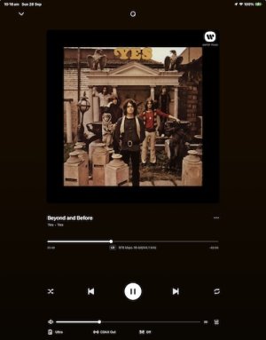

The second screenshot is after rotating to portrait mode, and shows the album title.

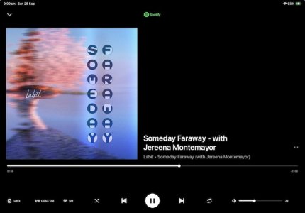

The third screenshot is after rotating back to landscape mode, and the album title is now shown.
It could be a coincidence but both examples have some type of duplication (Montemayor/Yes); have you seen it on others without?
Yes, it now seems to be on everything I play in landscape mode, but it can be made to show the full details after doing the rotation to portrait and back to landscape trick.
