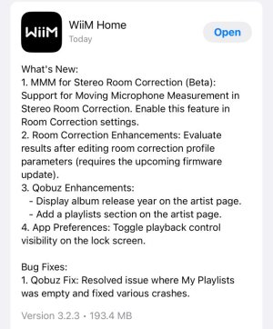

8. [Android] MMM for Stereo Room Correction (Beta): Support for Moving Microphone Measurement in Stereo Room Correction. Enable this feature in Room Correction settings. The Moving Microphone Measurement (MMM) for Left/Right Room Correction is coming soon. Stay tuned!

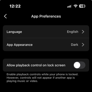

10. Lock Screen Controls for Various Inputs: Support for controlling playback directly from the Lock Screen, except for Bluetooth input.
