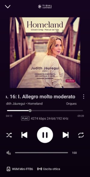

I recently bought a Wiim Pro and a Tidal subscription with the goal of streaming hi-res music using Tidal Connect.
What I am finding is that while Tidal Connect works most of the time, it sometimes struggles and this seems to be worse as the sampling rates increase.
24/96 is bad, 24/192 is worse but everything else is more or less reliable.
The problem is usually difficult to reliably reproduce but one album (below) is consistently hopeless.
Using Tidal Connect on the Wiim Pro I can't play more than ~30 seconds from this album, yet when I play it on my Android tablet speakers (still 24/192) it works fine.
The problem album:
Judith Jáuregui, Homeland, 2024
It works fine in the app but fails every time over Tidal Connect to the Wiim Pro.
The problem album:
Judith Jáuregui, Kaspar Zehnder & Orquesta Sinfónica de Castilla y León - Homeland
Listen to Homeland on TIDAL
tidal.com
