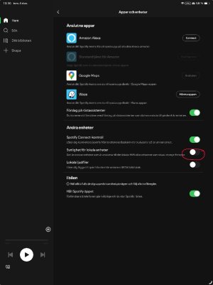

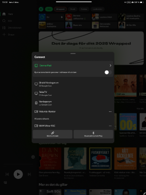

Correction, It don´t work with official IOS 26 with my Wiim Ultra. A workaround is not to toggle the marked switch in Spotify settings. The Ultra will show up indicating it is on another network.
