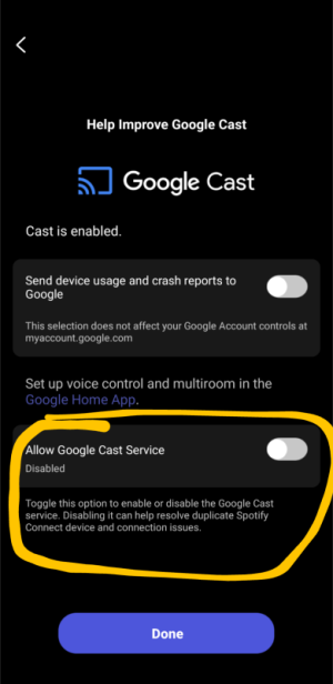

Counter intuitively you need to enable Chromecast on the WiiM device then disable casting in settings.
I had it enabled and then disabled and then i added it again... the dns command you send reflected it properly in the Add/Remove column

I've experienced the same issue with Wiim Ultra and Wiim Pro Plus.
The workaround of enabling and disabling Chromecast works on the Ultra but not on the Pro Plus as there is no disable Chromecast option.
Remember when things just worked and if it didn't it was because you did not configure it correctly.
For the pro plus, go into its settings, then choose Google cast, then on the next page, choose your pro plus. On the next page there's an "allow Google cast service" toggle. Does toggling that off not work?

Could you be a bit more clear here? Specifically do you mean a WiiM device on which Google Cast was never enabled advertising _googlecast._tcp. via mDNS/DNS-SD as I described here:
or a WiiM device on which the toggle for 'Allow Google Cast Service' in the Google Cast section of the WiiM app that appears once Google Cast has been enabled is switched off continuing to advertise _googlecast._tcp. ?
The latter would be a new bug. The former has been reported several times here.
The latter i have tested in my Ultra and works as it should.
