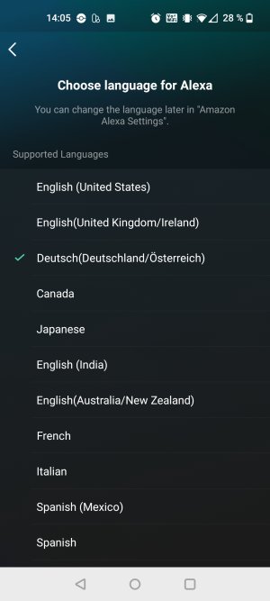

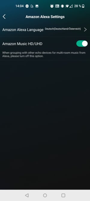

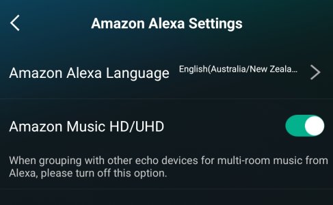

These are my language settings

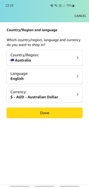

And my Amazon Account

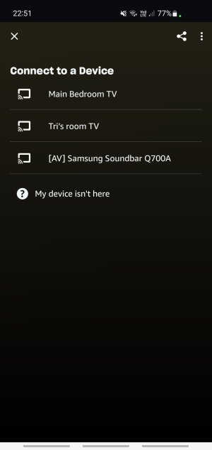

Can you post a screenshot of the AlexaCast device connection screen?

This screen?
