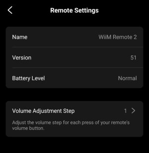

I have adjusted volume steps to increase/decrease by 5 steps at a time, both from remote and from knob. And Im happy with that

The volume steps already work for HDMI/CEC using the Wiim app and Wiim remote, but with the TV remote it ignores the user's step setting and increments by 1. i.e. It takes a fair amount of time to affect the relative volume (say from 1 to 25). Frustratingly so. That's why the step setting exists.
