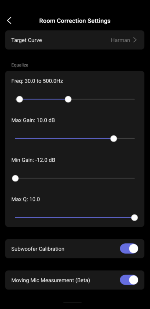

I just ran the RC with the parameters you suggested. How do I know that RC is being applied? The settings show Equalization is off, and I don’t know where to look to see if RC is on.
After RC is completed there should be a new "Auto" set of filters in the PEQ filters list and this should be enabled automatically. You probably need to select "Complete correction" after the final evaluation stage or something like that.
