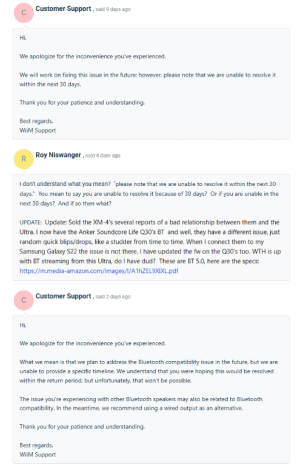

This is what tier 1 support said in response to my case:
Code:
Hi,
We apologize for the inconvenience you've experienced.
What we mean is that we plan to address the Bluetooth compatibility issue in the future, but we are unable to provide a specific timeline. We understand that you were hoping this would be resolved within the return period, but unfortunately, that won’t be possible.
The issue you're experiencing with other Bluetooth speakers may also be related to Bluetooth compatibility. In the meantime, we recommend using a wired output as an alternative.
Thank you for your patience and understanding.
Best regards,
WiiM Support

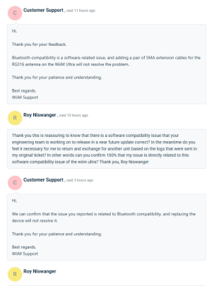

I have some key updates from the WiiM support team. The process is normal here, there's a tier 1 tech that communicates with me and they then communicate with the engineering team. The key take aways here are:
1. They state there IS a WiiM Ultra BT software combability issue.
2. They state they are working on a resolution but ETA is unknown.
3. I inquired about adding a BT antenna/aerial and they suggested this is not necessary.
Thank you.
