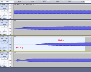

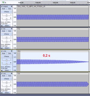

Fade-out:
Fade-in:
All on the Pro. First row - source audio, next one - content played with LMS and DLNA, gapped playback, then - content played with WHA, and the last one - content played with LMS and chromecast.
The scenario above is when the stream starts or ends, ie. sample rate changes.

Fade-out:
Fade-in:
Dear onlyoneme, mind kindly elaborate a bit more on the difference between the 2nd and 3rd fade in graph? I suppose the 3rd graph content played with WHA (WiiM home app?) should be the same as the 2nd which means they are both playing back using the DLNA protocol.
I would like to figure out if this is evidencing the fade in problem I've contributed to another forum thread about missing the beginning of a track when I play through home server using the WiiM home app installed in my iphone as control point.

Both were for DLNA content, but playback control methods vary and have an impact on the final result. WHA uses Linkplay extension over UPnP standard to preserve gapless playback, it's a full queue sent to the device. LMS uses SetNextUri to let the device know in advance which song should be played next. And for short songs it uses SetUri for gapped playback instead of gapless.

There is no short answer. LMS is able to deliver gapless playback over DLNA with the DLNA bridge plugin, but it does not always work as expected with WiiMs. For short tracks up to 10 seconds a gapped method of playback is used instead.
The differences between WHA and LMS/DLNA are for fade-outs rather than fade-ins. I will re-evaluate the current behavior later today or tomorrow to find out if there are any improvements here, as my previous tests are quite old.

You don't really get this issue with LMS at all if you use the UPnP/DLNA Bridge.
He will face fading in every non gapless scenario - starting the stream, stopping it manually, switching to another song, forced gapped playback of short tracks, playback of files with different sample rates or even different formats sometimes, etc.
I am talking about the UPnP/DLNA Bridge plugin NOT the UPnP/DLNA Media Interface plugin. Are you saying that a fade in is applied in this mode?
Of course, as it is applied by the WiiM device itself.
