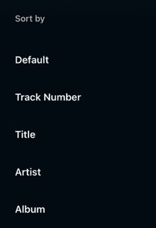

Assuming your tags were copied over correctly, you should be fine. Here are the sort/play options for the WiiM Amp USB:
Edit: removed ref to filename as that’s not a tag…
