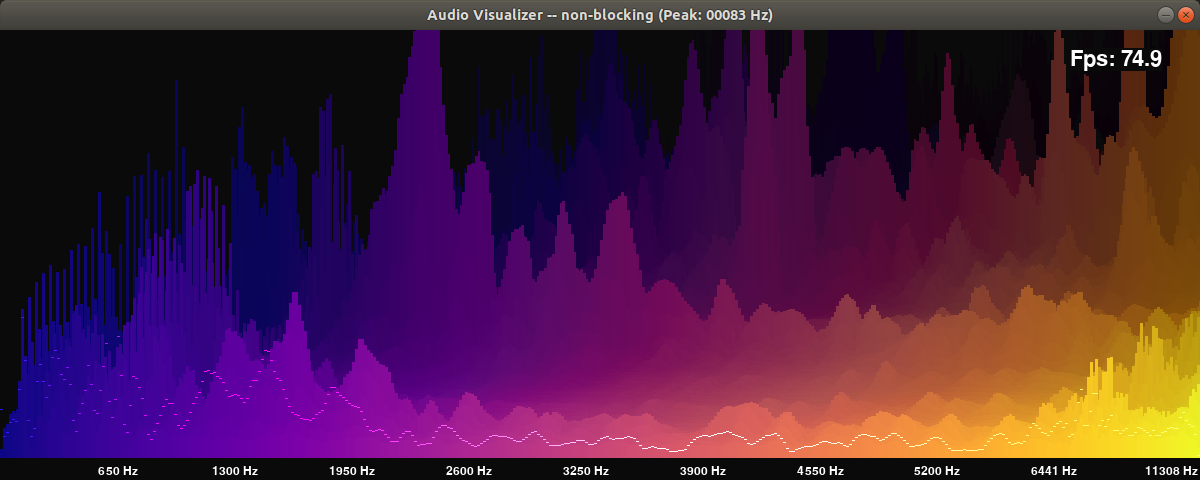

Does JustBoom Digi hat can receive Toslink input? When I checked out the product description, it sounds like it outputs only.Couldn’t get the Quadra to rotate properly to this wide screen, so moved everything over to a Pi 3A, which just happens to have a JustBoom Digi hat with Toslink in. Looking pretty. Now the hard part of getting metadata from the WiiM and integrating it into someone else’s code. Ugh.
Ah, you’re correct. It reports in ALSA as the Justboom, but it’s actually a board I bought long ago from Tindie. The USB dongle is cheaper.Does JustBoom Digi hat can receive Toslink input? When I checked out the product description, it sounds like it outputs only.
Is this screen the one now showing in the "listening now" thread? It seems to be looking like a beautiful match with the RME width/color/height.Couldn’t get the Quadra to rotate properly to this wide screen, so moved everything over to a Pi 3A, which just happens to have a JustBoom Digi hat with Toslink in. Looking pretty. Now the hard part of getting metadata from the WiiM and integrating it into someone else’s code. Ugh.
Yes, I got sidetracked, put the Peppy integration on the back burner, in favor of adapting my own code to this screen. Working well, and is a near-perfect match for the RME, down to the black painted metal bezel.Is this screen the one now showing in the "listening now" thread? It seems to be looking like a beautiful match with the RME width/color/height.
