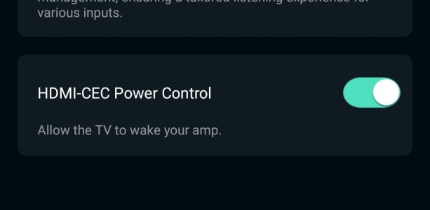

The amp is connected directly to the tv (no switch) with the included cable. I'm on the latest firmware 5.0.606744 and the settings for detecting a signal over hdmi and allowing the tv to control the amp are active. I tried deactivating one or both of them but it makes no difference for my issue. It feels like there is a problem with the cec implementation on the amp.
