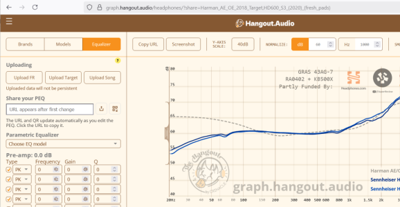

Hi,
So, going to the https://graph.hangout.audio/headphone and then the equalizer tab you should see this:

Dear @jeromeof, thank you so much for providing this detailed step-by-step guide.
For some reason the link "https://graph.hangout.audio/headphone" does not work for me (Error 404, I guess the "s" at the end of headphones is missing?).
The link you had initially given works (https://graph.hangout.audio/), but when I go to the "headphones" page it does not display the "Device PEQ" section:
Yes sorry it is https://graph.hangout.audio/headphones - I can't updated the other post but hopefully people find it here.
@jeromeof , I just figured out that the section "Device PEQ" is not visible when I open the page with my default browser Firefox. When I use Chrome or Edge it is visible. I will give it a try the next days.
Thank's a lot again for the detailed guide.
Yes, thanks for reminding me. Since DevicePEQ started as a tool for pushing PEQ to usb cables and dongles (like the new CrinEar Protocol Max) - this capability was not supported on Firefox or Safari ( it is a Chrome / Edge feature ) but I guess I can now enable the Network devices like the WiiM on all browsers.
