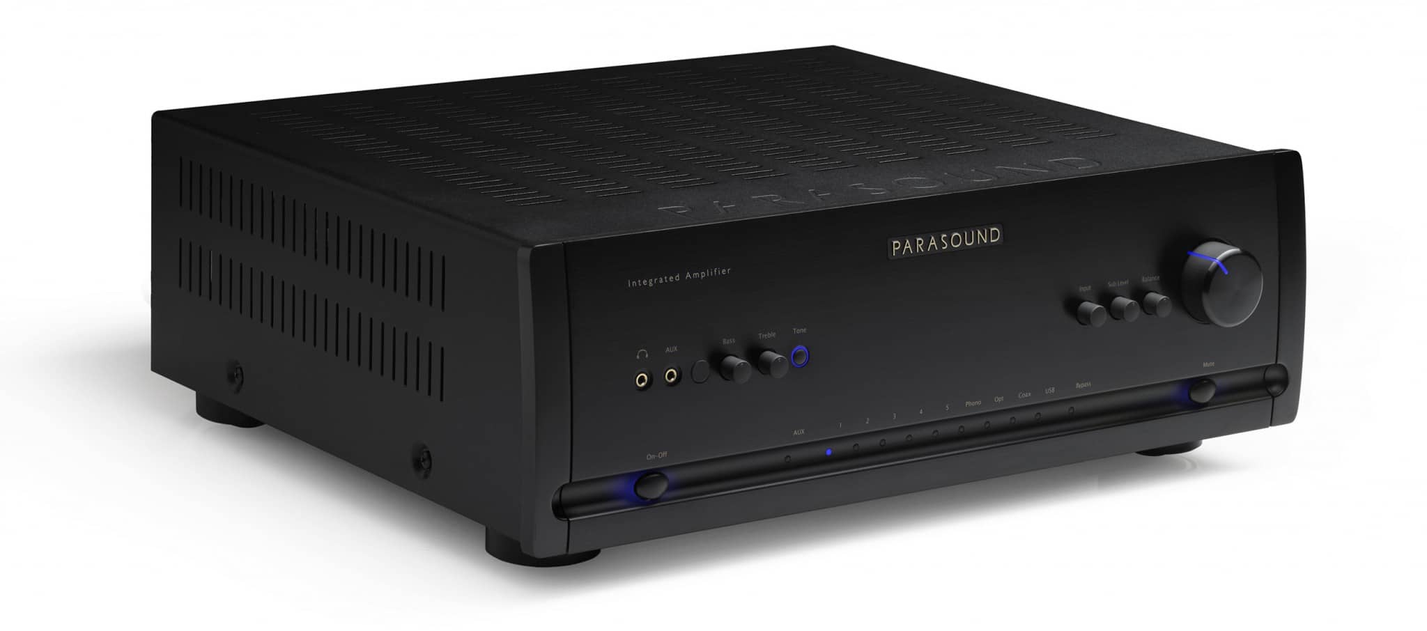

My Integrated Amplifier has this feature (analog bass management) but I switched to the Wiim sub out for the timing correction and flexibility and now just run the it as a basic power amplifier.
I saw an analog crossover on facebook the other day:
What integrated amp do you have?
It's an oldie but goodie...
