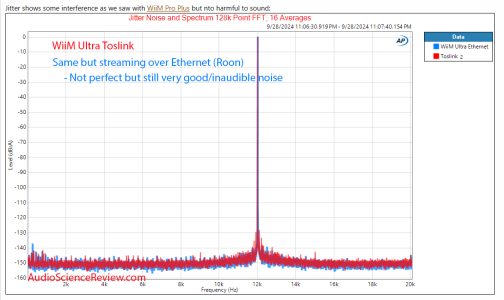

The clocking on the Ultra is very stable, as Amir's review on ASR shows us. Not absolutely top of the class, but better than most other devices he's measured.

Talking about re-clocking only make sense for the S/PDIF interfaces.
The USB connection is asynchronous and don't include any audio clock. The receiving device always have to provide its own clock.
